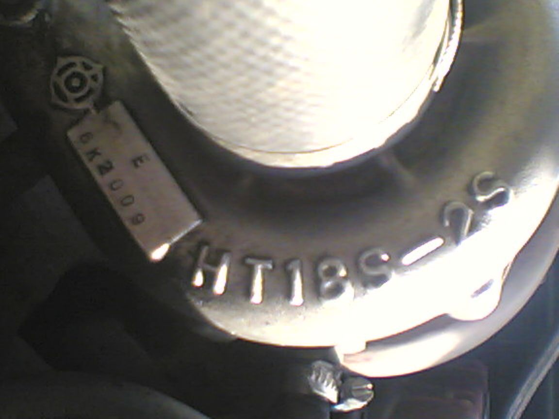

fiesta_xr2i Posted July 25, 2005 Author Posted July 25, 2005 det står ikke no tall på min turbo 2012 Focus 1.0 Ecoboost Stv 125 hk X 2004 Focus ST 170 Imperial Blue X 87/91 sierra cosworth 4x4 stage 3 X 01 mondeo 2,0 tdi stv 115hk X 92 fiesta xr2i 1,8 16v (RS1800) X 88 sierra 2,0 sedan X 90 sierra 2,0i combi

fiesta_xr2i Posted July 25, 2005 Author Posted July 25, 2005 dette står på min turbo :s 2012 Focus 1.0 Ecoboost Stv 125 hk X 2004 Focus ST 170 Imperial Blue X 87/91 sierra cosworth 4x4 stage 3 X 01 mondeo 2,0 tdi stv 115hk X 92 fiesta xr2i 1,8 16v (RS1800) X 88 sierra 2,0 sedan X 90 sierra 2,0i combi
ford-racing Posted July 26, 2005 Posted July 26, 2005 du har ikke org turbo. syns jeg så noe da du la ut bilde av motor rommet dit. legg ut det igjen er du snill? "Don`t find fault, find a remedy; anybody can complain" ~Henry Ford

fiesta_xr2i Posted July 26, 2005 Author Posted July 26, 2005 du har ikke org turbo. syns jeg så noe da du la ut bilde av motor rommet dit. legg ut det igjen er du snill?<{POST_SNAPBACK}> her er motor-rommet mitt 2012 Focus 1.0 Ecoboost Stv 125 hk X 2004 Focus ST 170 Imperial Blue X 87/91 sierra cosworth 4x4 stage 3 X 01 mondeo 2,0 tdi stv 115hk X 92 fiesta xr2i 1,8 16v (RS1800) X 88 sierra 2,0 sedan X 90 sierra 2,0i combi
