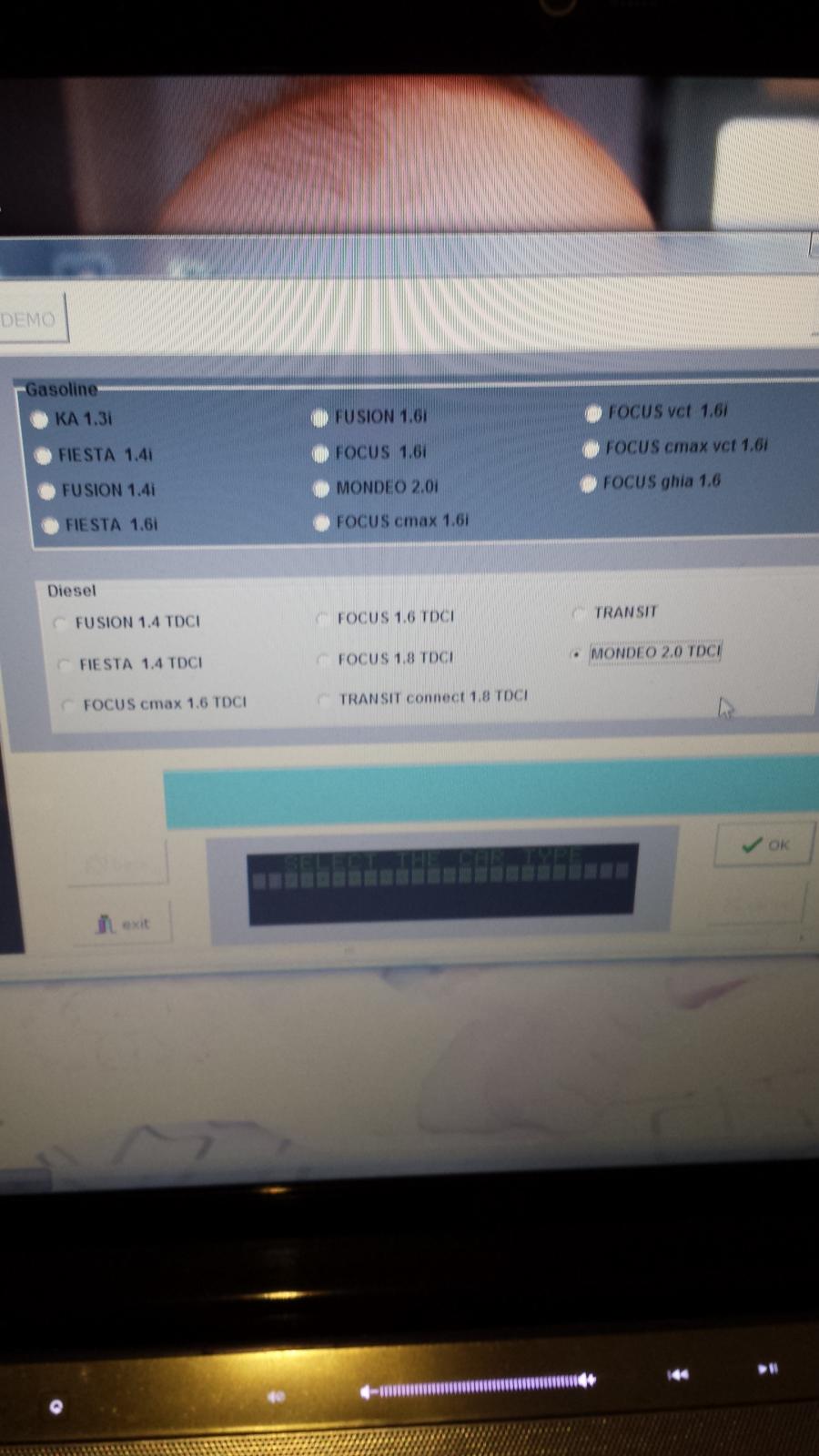

Fakeworth Posted June 23, 2015 Posted June 23, 2015 Leseren er I hus og fungerte som bare det, takk for linken Spock! Jeg kan sjekke programmet om hvilke biler som var listet opp om du vil vite JTDevil? Nå har jeg endelig fått lest av kodene mine og jeg har ikke same kodene som er nevnt tidligere I tråden faktisk.jeg har: P0503 - Vehicle Speed Sensor (VSS) Intermittent Indicates poor or noisy VSS performance. Vehicle speed data is received from either the vehicle speed sensor (VSS), transfer case speed sensor (TCSS), anti-lock brake system (ABS) control module, generic electronic module (GEM), or central timer module (CTM). Noisy VSS/TCSS input signal from Radio Frequency Interference/ Electro-Magnetic Interference (RFI/EMI) external sources such as ignition components or charging circuit.Damaged VSS or driven gears.Damaged TCSS.Damaged wiring harness or connectors.Malfunction in module(s) or circuit connected to VSS/TCSS circuit.After market add-on.Monitor VSS PID while driving vehicle, check for intermittent vehicle speed indication. Verify ignition and charging system are functioning correctly. P1500 - Vehicle Speed Sensor (VSS) Intermittent Indicates the VSS input signal was intermittent. This DTC is set when a VSS fault interferes with other OBDII tests, such as Catalyst efficiency monitor, EVAP monitor, HO2S monitor, etc. Intermittent VSS connectionsIntermittent open in VSS harness circuit(s)Intermittent short in VSS harness circuit(s)Damaged VSSDamaged PCM Er det noen som har vært borti disse? Ser ut som den trenger et sensor bytte bare? -93 Sierra Cosworth STV 4x4 X: -94 Escort Cosworth HTT, -94 Escort cosworth T-25, -94 Escort cosworth T-34, 4x -90 Sierra 4x4 Cosworth, -91 Sierra Cosworth 2wd, - 89 Sierra Cosworth 2wd, -88 Sierra Cosworth 2wd -91 Scorpio Cosworth
JTDevil Posted June 23, 2015 Posted June 23, 2015 Ja Fakeworth, gjør gjerne det! Hvis min bil står der så vet jeg ihvertfall hva jeg skal bestille rimelig kjapt! - '05 Ford Focus 2.0 TDCi Titanium
Fakeworth Posted June 23, 2015 Posted June 23, 2015 Står ikke på lista, men skjønner ikke helt at den ikke skal fungere. Går jo ann å spørre de som lager den evt. -93 Sierra Cosworth STV 4x4 X: -94 Escort Cosworth HTT, -94 Escort cosworth T-25, -94 Escort cosworth T-34, 4x -90 Sierra 4x4 Cosworth, -91 Sierra Cosworth 2wd, - 89 Sierra Cosworth 2wd, -88 Sierra Cosworth 2wd -91 Scorpio Cosworth
